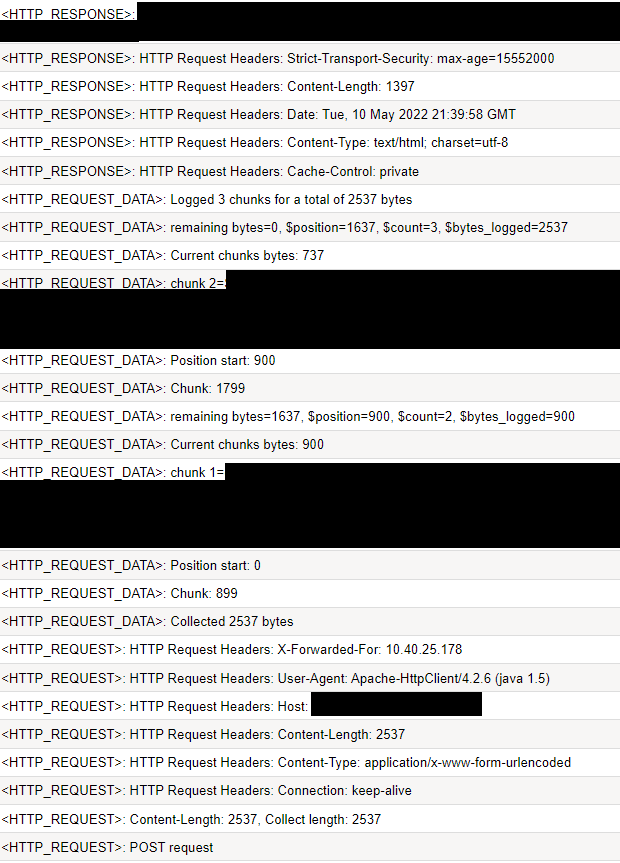

I have an irule (much of which I found here) that is to gather some much needed troubleshooting data I need in regards to the headers and payload I have coming in.  The payload is obvisouly too large for a single log line so this was supposed to chunk it into manageable bytes.
I had to make some modifications to the original irule which did not work, but now it is working, sort of.  It logs the first 900 bytes as it should, then something happens and skips a bunch, and then logs the final bytes of data.
I can't understand why it's not grabbing either the proper amount of data or failing to output this second chunk of missing data before making its final loop.

The image below shows what I'm talking about - it even says "Oh I found 3 chunks", but I'm only being presented 2.
I added some logging around the position, chunk value (aka end position), and bytes logged to help illustrate that it's clearly skipping over something.
Any help would be appreciated!
Thanks

    • Log4j2's avatar
      Log4j2
      So I increased the max_char value to 1024 but I'm still getting the same issue, just more data in the first chunk.
      This time I've splatted the response to properly represent how many characters I'm actually getting back:

      So based on the # of characters I'm passing in vs what I'm getting logged doesn't add up - I have data that should be in "chunk 2" that is missing and that last bit should be "chunk 3"

  • How about somehting like this:
    for { set start 0; set end $static::max_chars} { $start < [HTTP::payload length] } { incr start $static::max_chars; incr end $static::max_chars } {
    	log local0.debug "$start:$end [string range [HTTP::payload] $start $end]"
