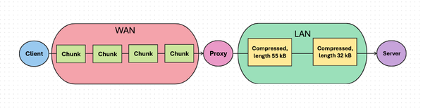

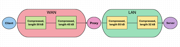

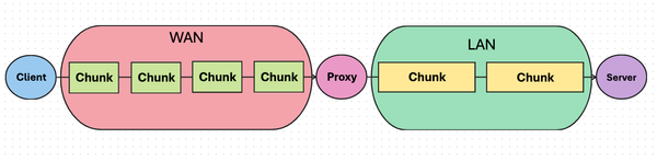

The key word is "encoding" and HTTP uses a header to communicate what scheme encodes the data in a message body. These can be used for functional purposes as well as communication optimization. In the case of Transfer Encoding it is most commonly leveraged for chunking, which is taking a large bit of data and breaking it up into smaller pieces that are sent between two nodes along a path, transparently to the application sending/receiving messages. These nodes may not necessarily be the source and destination of an HTTP conversation, so proxies in between could transparently reassemble the chunks for differing parts of the path. It does not use a content-length header:
ex. Transport conditions on the LAN may support larger chunks than the WAN, so each segment between nodes in a data path could be configured for different chunking in such a scenario
Contrasting with Content Encoding, which is more commonly used for compression of message bodies (although this can be done with transfer encoding too) and requires the length to be defined. Proxies along the path are expected to not change these values, but this is not always the case.

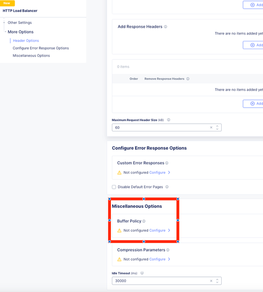

And after applying the config, we go back to the HTTP Load Balancer dialog, to the Other Settings section and configure a Buffer Policy under Miscellaneous Options:
A value configured in that dialog (it is the only property aside from an enable checkbox) will limit the request size to the specified value in bytes, but it has the added benefit of allowing the Distributed Cloud proxy to buffer the chunked requests and then convert them into content-encoding friendly values with length specified, and then send to the server via an HTTP 2 connection.
