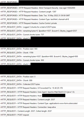

iRule [string range...] not chunking data properly
- May 11, 2022
In fact I have just grabbed this from an iRule i recently wrote. Almost the same, with fixed values. Note the end is 99 but the increment is 100. As you say, string range is zero-indexed
for {set start 0; set end 99} {$start < [HTTP::payload length]} {incr start 100;incr end 100} { log local0.debug "[string range [HTTP::payload] $start $end ]" }
This sounds like the limit "900" that is set in the static variable because of F5 limit "The syslog facility is limited to logging 1024 bytes per request. Longer strings will be truncated." . You may increase the limit static:max_chars to 1024 as each character is 8 bits (1 Byte) and it seems to me that this is your issue and also try using HSL remote logging to your syslog server or SIEM like splunk/elk/qradar etc. without logging locally as then maybe the limit of 1024 will not apply.
https://clouddocs.f5.com/api/irules/log.html
Also you play a little with the F5 HTTP profile and the chrunking to see if it helps changing it to the different modes:
https://support.f5.com/csp/article/K5379
So I increased the max_char value to 1024 but I'm still getting the same issue, just more data in the first chunk.
This time I've splatted the response to properly represent how many characters I'm actually getting back:
chunk1
xxxx_xxx=<xxxxxxxxxxx> <xxxxxxx>xxxx_xxxxxx</xxxxxxx> <xxxxxxx>xxxx://xxxx_xxx</xxxxxxx> <xxxxxxxxxxxxxxxxxxxx>x2xx37xx-0x94-4xx4-x70x-3xx74xx1x075</xxxxxxxxxxxxxxxxxxxx> <xxxxxxx>1.7</xxxxxxx> <xxxxxxxxxxxxxx>${xxxxxxxxxxxxxx}</xxxxxxxxxxxxxx> <xxxxxxxxxxx>100</xxxxxxxxxxx> <xxxxxxxxxx>100x</xxxxxxxxxx> <xxxxxxxxxxxxxx>12345678</xxxxxxxxxxxxxx> <xxxxxxxxxxxxxxx>x</xxxxxxxxxxxxxxx> <xxxxxxxxxxx>xxxx xxxxxxxxxxxx x - xxxx_xxxxxx-91</xxxxxxxxxxx> <xxxxxx>69420</xxxxxx> <xxxxxxxxxxxx>840</xxxxxxxxxxxx> <xxxxxxxxxx>4000000000001000</xxxxxxxxxx> <xxxxxxxxxxxx>01</xxxxxxxxxxxx> <xxxxxxxxxxx>2021</xxxxxxxxxxx> <xxxxxxxxxxxxxxxx>xxxx</xxxxxxxxxxxxxxxx> <xxxxxxxxxxxxxxxxx>x</xxxxxxxxxxxxxxxxx> <xxxxxxxxxxxxxxx>xxx</xxxxxxxxxxxxxxx> <xxxxxxxxxxxxxx1>1600 xxxxxxxxxxxx xxxx.</xxxxxxxxxxxxxx1> <xxxxxxxxxxxxxx2/> <xxxxxxxxxxxx>555-8675-309</xxxxxxxxxxxx> <xxxxxxxxxxx>xxchunk2
xxxx/3.1</xxxxxxxxx> <xxxxxxxxxxxxx>xxxx/xxxx,xxxxxxxxxxx/xxxxx+xxx,xxxxxxxxxxx/xxx;x=0.9</xxxxxxxxxxxxx> <xxxxxxxxxxxxx>xxx</xxxxxxxxxxxxx> //<xxxxxxxxxx>01</xxxxxxxxxx> <xxxxxxxxxxxxxxxxxxxxxxxx>03</xxxxxxxxxxxxxxxxxxxxxxxx> <xxxxxxxxxxxxxxxxxxx>01,02</xxxxxxxxxxxxxxxxxxx> <xxxxxxxx>xxx64xxx-x19x-4728-8849-x3x50xxxxx39</xxxxxxxx> <xxxxxxxxxxxxx>${xxxxxxxxxxx}</xxxxxxxxxxxxx> <xxxxxxxxxxx>12341234</xxxxxxxxxxx> <xxxxxxxxxxxxx>xxxxxxxx</xxxxxxxxxxxxx> </xxxxxxxxxxx>
My original request is like so:

</xxxxxxxxxxx>So based on the # of characters I'm passing in vs what I'm getting logged doesn't add up - I have data that should be in "chunk 2" that is missing and that last bit should be "chunk 3"
