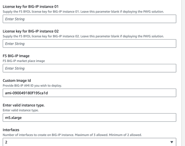

      Have you subscribed to the offer you are calling in AWS marketplace (This is common - If you have not subscribed you will never see an instance deploy to EC2, failure of the deployment takes about 15 minutes)?  Did you select an instance type that is supported or is there a capacity issue  ( m5.2xl or m5.xl are safe buts but we support many instance types - this is less common?  If the instance deployed but was deleted it was either a lack of another resource (check for other errors in the CFT logs) or the CloudFormation VPC endpoint was not reachable (in this case you will see the CFT running and get stuck at the end).

  • I did subscribed. Yes it dies after 15m. Instance type is default one.

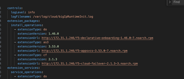

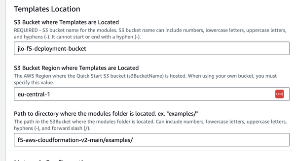

    - having my own bucket with copied repository
    - using my apache http server with needed files
    • we want to use BYOL but I dont have license yet, wanted to do that after or generate trials for a moment

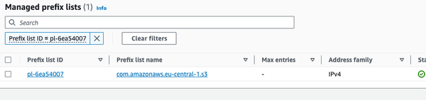

    - not sure here about the S3 gateway, from link you provided there are multiple routes attached to it, but I dont understand what is needed there.

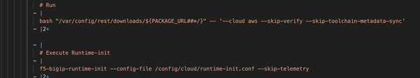

    - changed startup init not to contact internet
    • changed to fetch files locally from my apache

  • IIRC correctly you will need the license keys to deploy the instances via the CFTs for BYOL, deploying manually from the marketplace you do not.  In the child stack deployment of the instance do you see this event?
