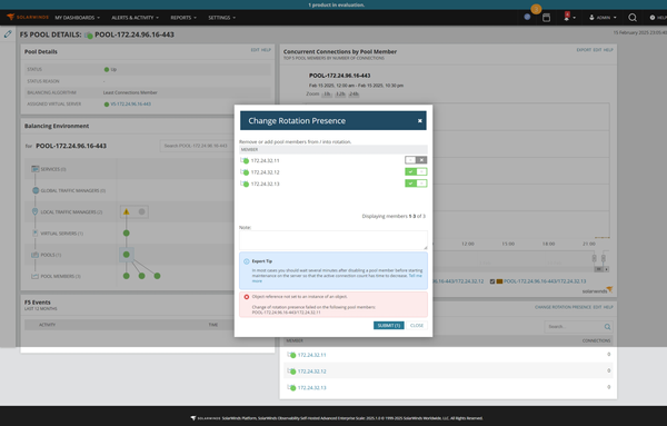

I agree, the Solarwinds documentation is not very comprehensive. No matter what I tried, I was unable to get their "change rotation presence" (i.e. take a pool member out of rotation) feature to work - even when using local admin or remote AD admin credentials. However, if you do not need this feature and you are looking for the least privilege access to integrate with Solarwinds, then you should create a local user on the BIG-IP with guest role access. From what I have tested, this guest role access allows you see the health of the virtual servers and pools (including whether health checks that are passing / failing).
Load Balancing Dashboard ScreenshotError Received When Trying to Take a Pool Member out of Rotation
