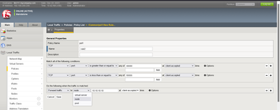

    it will be tidier if you put .52 and and .58 in separate pools so you dont need to define pool member in the irule.
    you can use pool's priority group activation in each pool if you want both to be members.
    btw, it's better to use gui based traffic policy to avoid scripting typo

    • JP-814's avatar
      JP-814
      Oh wow, I didn't consider policy for this effort. That makes much more sense, thank you for that info! 😄
