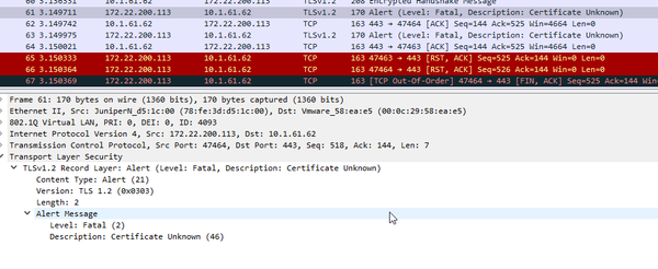

I tried this on 12.x and 13.x, so ssl debug should give me the reasons anyway , and then i disabled the generic alert in the profile too, but still nothing in the ltm log.
In the pcap I do see fatal errors, I am thinking this is just because this cert i am using is not a browser trusted one as of now.
But i dont see why that should cause ssl handshake failures.

What do you mean it allowed the connection? From your Wireshark capture, the handshake failed.

Hi Rodrigo,
Well I was still able to see in the capture that the SSL handshake still throws the same error but it then continues to load the page.
