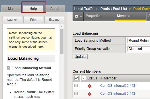

    You can get the same information from the Configuration Utility (GUI) too: Just click the Help tab.
