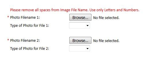

Let’s say we have a web application with a form field that permits the upload of arbitrary files. It would appear to the user similar to the below:
Aside from photos, the application may permit users to upload Word documents, Excel spreadsheets, PDF’s, and so forth.

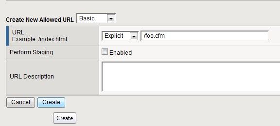

Assuming the upload is specific to a given URL, create that URL in the ASM policy.

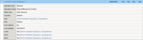

Attack signatures have a defined scope, as seen below:
This information can be found in ASM under “Attack Signatures List”. As an example, search for ‘Path Traversal’ attack types and expand signature id’s 200007006 and 200007000:
A signature with a ‘Request’ scope does not pay any attention to parameter extraction – it just performs a bitwise comparison of the signature to the entire request as a big flat hex blob. So to prevent this signature from being triggered, we can (a) disable it, (b) use an iRule to disable it on these specific requests.

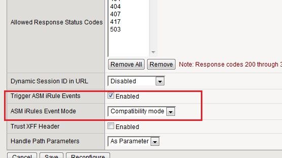

Before we can use iRules on an ASM policy, we need to switch on the ‘Trigger ASM iRule Events’ setting on the main policy configuration page. Further information can be found at: https://techdocs.f5.com/kb/en-us/products/big-ip_asm/manuals/product/asm-implementations-11-5-0/27.html.
