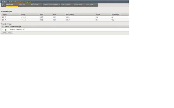

Hi All,
I´m using Big IP VE on wmvare.
I have upgraded BIG IP to new version, but I have a lot of problems.
Problems are connected with linux, after upgrade doesn´t work: winscp, I cannot instal anything because yum does not work...etc, I cannot find older commands by pushing up arrow.
I guess the best thing will be to downgrade it back, but problem is, that I cannot do it because old Image is not in Available Images (It have never been there), so I cannot make install and because of it in boot location I cannot swap images.
Could someone help me with ?

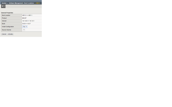

  • Hi
    If your config is already present on HD1.1 then when using Boot Locations, don't select "Install Configuration" when activating the previous volume.
    Alternatively, use the switchboot command from the cmd line to switch volumes and then reboot
  • Hi iaine, when I will not use Install configuration, will I have current configuration, or there will be default?
  • Hi
    If you don't install the config, then you will load the volume with the configuration that was on it when it was last used. So, if 1.1 was the volume that you upgraded from then you will get the config prior to your upgrade/reboot. If 1.1 is an empty volume, then you won't have any config.
    Either way, if you reboot to 1.1 then you always have the option to reboot back to 1.2 if you want to, just don't select "Install Config"
