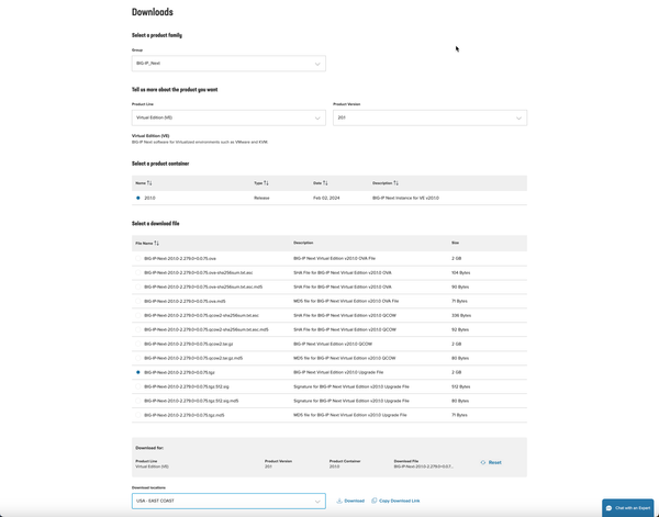

The first step in the upgrade process is to download the BIG-IP Next instance upgrade package.
Next, download the signature for the instance upgrade package.

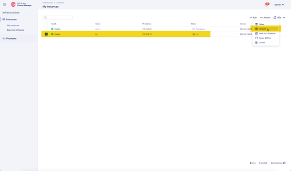

Log into Central Manager, select an instance, and then on the actions drop down select upgrade.

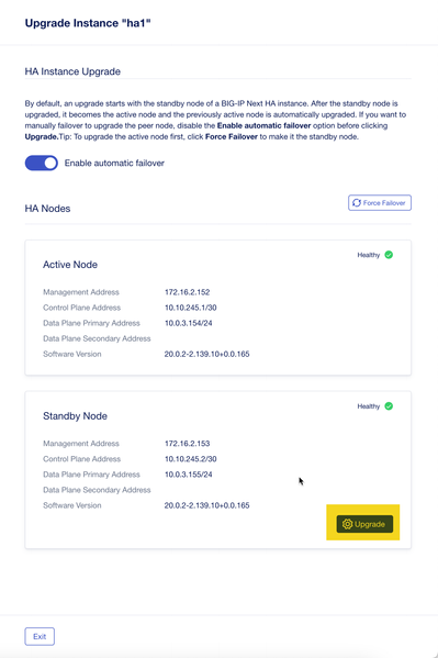

Because I selected an HA pair, I see the screen below giving me the option to disable automatic failover (enabled by default) and to force a failover if I want to upgrade the active node first. I chose the defaults here and selected upgrade.

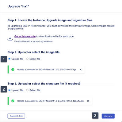

If you are upgrading a standalone, the previous step is skipped and you are asked to upload the image and signature files. Select and upload the files, and when you have the "green is good" notifications, select upgrade.

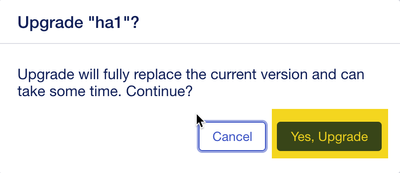

At the dialog that pops up, select yes, upgrade.

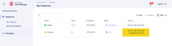

At this point, you can exit out to your instance list and you'll see the upgrade process in the list.

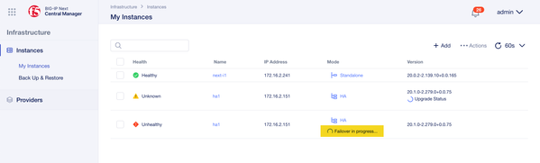

There is a brief state where I saw both of the instances in the HA pair in the listing during failover as shown below.

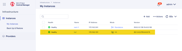

After both instances have been updated, you should see the new version in the listing and a healthy state!

If you are upgrading a standalone, the previous step is skipped and you are asked to upload the image and signature files. Select and upload the files, and when you have the \"green is good\" notifications, select upgrade.
