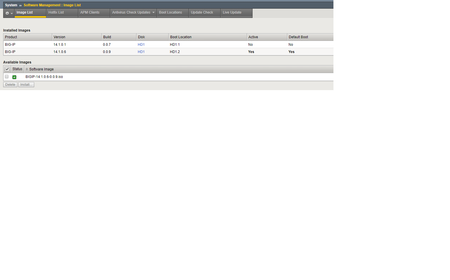

Issue after upgrade from 14.1.0.1 build 0.0.7 to 14.1.0.6 build 0.0.9
- Sep 05, 2019
OK. Are you using the Management IP to SCP to the device rather than a Self IP? I'm assuming that you can SSH to this IP without issue, is this correct?
If using a Self IP - what are your Port Lockdown settings set to?
Do you have AFM provisioned? Do you have any AFM policies blocking your access?
What account are you using to connect? If you are not using root, can you try using this a/c
Is the SCP daemon running? ps aux | grep scp
Are your SCP requests actually getting to your device. Close down any SSH sessions, then from vConsole run a tcpdump and see if your connection requests are hitting your F5
tcpdump -ni eth0 port 22
