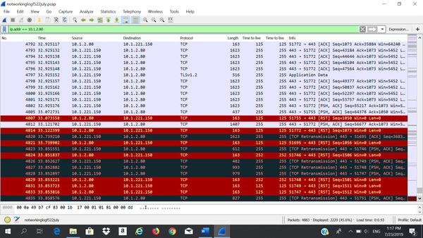

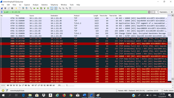

You have only shown your observations of the traffic between F5 and the back-end application servers. What were the characteristics of the traffic between your client and F5?
- mithuuu85
HI,
Below are the Packet observed between Client to F5 and to server during the issue occurrence time.
1) Server responses with TCP Window Full
2) Then F5 respond back with TCP Zero Window from self-ip
3) we can see RST which is PSH ACK from the virtual server to the client
4) Then self-ip resets the connection to pool member due to rst from client.
Also we observed if the page was not loading fully and if we do some changes on the Virtual server after that page will open properly looks like new session/Cache clearing will make to work again.
This issue is not coming when we bypass the F5, It is working perfectly fine without any problem .

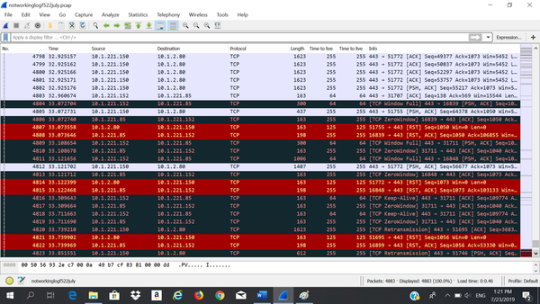

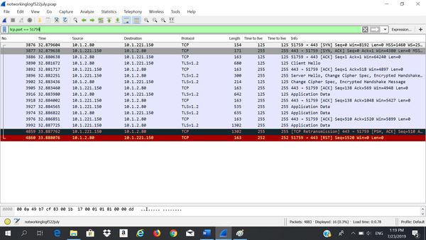

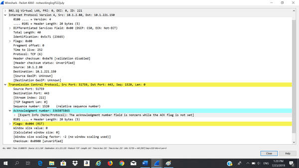

You can get a screenshot of the Wireshark window.
- mithuuu85
Hi,
Attached the screenshot of the Wireshark window.
- mithuuu85
Hi,
Attached the screenshot for wireshark window
- mithuuu85
Hi,
Below are the details about the IP address.
Client IP - 10.1.2.80
VIP IP - 10.1.221.150
Self IP - 10.1.221.85
Server IP - 10.1.221.152
