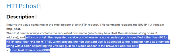

  • HTTP::host may contain port number, e.g. aaa.bbb.ccc:8888.
    so you need to remove the port number.
    • rct101's avatar
      rct101
      Site is using standard HTTPS 443
