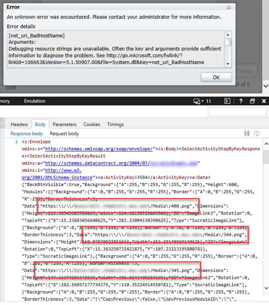

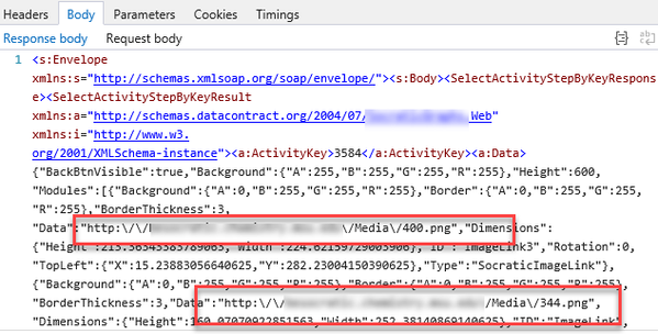

The stream profile is successfully replacing the HTTP: with HTTPS:, but is also including the additional backslash and a Silverlight (smh) error pops up
When I remove the second backslash in the iRule, the HTTP: is no longer replaced with HTTPS:, and I'm back to square one.
Any ideas on what I might be doing wrong? Thanks in advance!

    Alright, problem solved. I finally got the escaped characters in the XML files to match and substitute like I wanted. Hopefully this helps someone else.
     when RULE_INIT {
        set static::search "http:\\\\\\\/\\\\\\\/oldapplicationdomain"
        set static::replace "https:\\\/\\\/newapplicationdomain"
    when HTTP_REQUEST {
         Disable the stream filter for all requests
            STREAM::disable
           HTTP::header remove "Accept-Encoding"
    when HTTP_RESPONSE {
         Check if response type is text
           if {[HTTP::header value Content-Type] contains "text/xml"}{
       Replace http:// with https://
       STREAM::expression @${static::search}@${static::replace}@
       Enable the stream filter for this response only
       STREAM::enable
