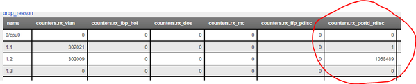

Hello everyone, i'm asking for your help in order to undestand some values i'm seeing when looking for the drop reason in my big ip devices
I have 2 big ip i5600 devices in an Active/Standby configuration and both of them are reporting packet drops
Both devices have a unique trunk of 2 interfaces (1.1 and 1.2)which process all the application traffic (the HA configuration use this trunk too).
When runnig tmsh "show /net interface" i can see 1.7M in the "Drops in" field.
When running "tmctl drop_reason" according to https://my.f5.com/manage/s/article/K31938413  i can see the field "counters.rx_portd_rdisc" with a value of "1058490" which i thinks its arround 1M.
Both devices reports similiar values for "counters.rx_portd_rdisc" but ONLY in the interface 1.2
I cant find any information related to the "counters.rx_portd_rdisc" field of the drop reason.
Someone have an idea of what "counters.rx_portd_rdisc" means?
Thanks in advance for your answers!

  • did you run through all of the tmctl commands in the KB article you posted?  Looks like you should get more details if you run this:  tmctl drop_reason
    • VictorRuiz's avatar
      VictorRuiz
      Thanks for your answer Jeffrey.
      The image attached is the output of tmctl drop_reason.
