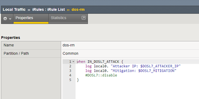

Created an iRule and attached to virtual server.
when IN_DOSL7_ATTACK {
    log local0. "Attacker IP: $DOSL7_ATTACKER_IP"
    log local0. "Mitigation: $DOSL7_MITIGATION"
    #DOSL7::disable

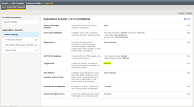

 I enabled the Trigger iRule on DoS profile of ASM module and the DoS profile attached to its respective virtual server.

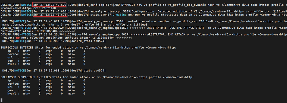

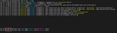

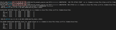

When I performed the DoS attack using locust tool on the F5 virtual ip then on the dosl7d.log, the attack was recorded -

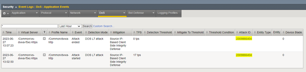

On GUI
On CLI:

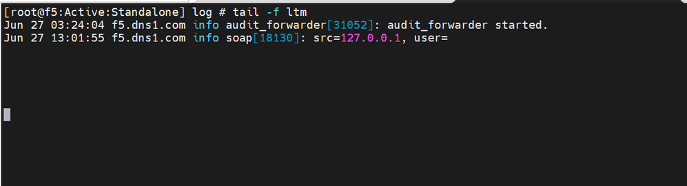

but there was simply just two entry on the /var/log/ltm
The iRule used is
Just a quick questions:
- Do i need to have additional configuraiton, or am i expecting the wrong entry of the DoS event on the ltm log?

  • The last post pictures was not good enough to identify the required details. So I will be posting the better image for the analysis.
    DoS trigger logs on /var/log/dosl7d.log
    Log on the /var/log/ltm
    Even with the use of iRule as provided on the DevCentral forum, it does not log the dos trigger event on the ltm /var/ltm/log.

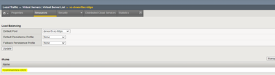

  • Better attach the irule under the virtual server as seen in https://clouddocs.f5.com/api/irules/IN_DOSL7_ATTACK.html as the irule option under the DOS profile is for layer 3/4 if I am not wrong and for the Flow_Init event https://clouddocs.f5.com/api/irules/FLOW_INIT.html .
    Also just in case enable the ASM Normal mode for irules in the ASM policy if it does not work.
    Still better forward the logs to a SIEM or BIG-IQ DCD and from there to send the email. Also there should be already logs in /var/log/dosl7/dosl7d.log
    • Nishal_Rai's avatar
      Nishal_Rai
      The current running version of the F5 BIG-IP is BIG-IP 17.1.0.1 Build 0.0.4 Point Release 1
      I have attached the iRule on the virtual server before:
      I even tried that but the same result, no dosl7d logs on the ltm.
      Regarding the dos logs:
      on the /var/log/ltm
      Both of these addressed solutions are not present with us, right now. So I'm looking for a workaround.
      I hope you understand.

  • Hi Nishal_Rai ,
    >> For your first Question : about Logs regarding L7Dos >>>
    I see that you are using CS ( Client side integrity Defense ) as a prevention/mitigation method.
    But using this Prevention method doesn't trigger your event "IN_DOSL7_ATTACK"
    According this : https://clouddocs.f5.com/api/irules/IN_DOSL7_ATTACK.html
    So First try to change it to rate limit for example , and monitor again.
