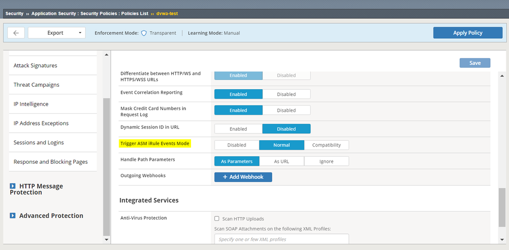

Also just in case enable the ASM Normal mode for irules in the ASM policy if it does not work.

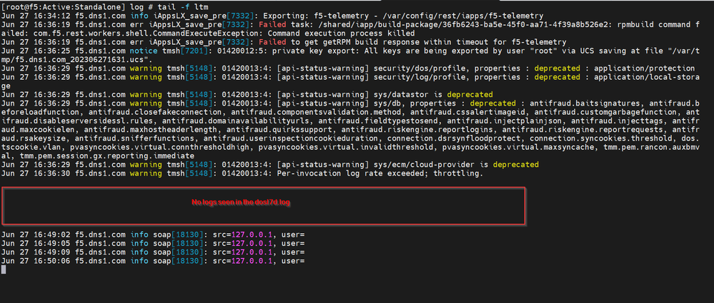

I even tried that but the same result, no dosl7d logs on the ltm.
Regarding the dos logs:
on the /var/log/ltm
Still better forward the logs to a SIEM or BIG-IQ DCD and from there to send the email.

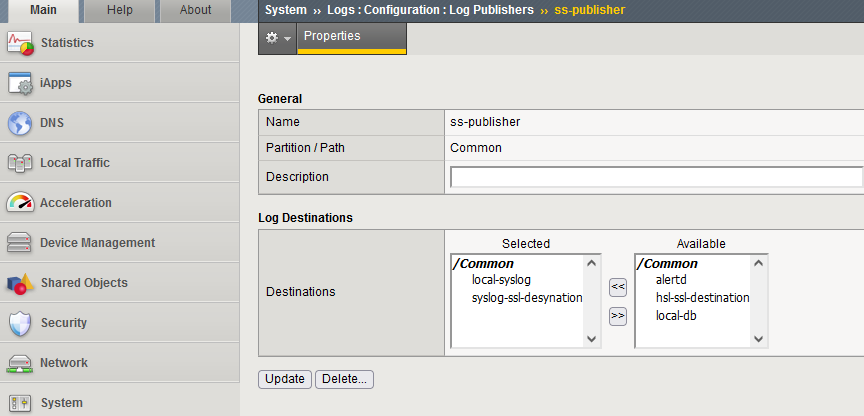

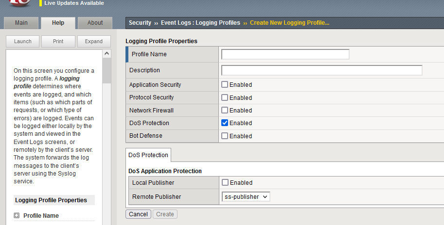

As a test workaround you can create a publisher for the logging profile that has the local-syslog as destination and a fake remote destnation and use it under the Security logging profile. Also enable the option in https://my.f5.com/manage/s/article/K03912652 (K03912652: Enable Log Publisher to log when a logging destination becomes unavailable)
