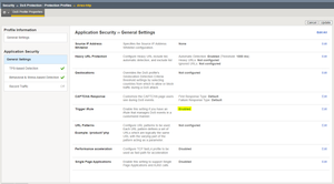

Hi Nishal_Rai ,
For your inquiry about how bigip AWAD L7 DDoS use the rate-limit prevention.....
Well ,
First you have two concepts >>> Detection interval & historical interval
Detection interval >>> Avg of TPS in last 10 sec
Historical interval >>> Avg of TPS in last 1 hour ( Which should be the Legitimate TPS )
Both of intervals updated each 10 sec.
Bigip Rate-limit by using simple equation : ( Historical intrval TPS + Configured threshold ) /2
For Example :
If you configured absolute threshold >> 200 TPS ( Like diagram you have sent above ).
and Let we assume historical intraval ( AVG TPS within hour ) >>> 100 TPS
So Bigip will rate-limit to 150 TPS.
Bigip will rate-limit if the TPS exceeded the absolute threshold , or if the ( Relative threshold + at least TPS ) violated.
> btw , you can review it from logs when attack started you can observe the Limit which bigip used when this attack started.
What is the Rate-limit mechanism , I have tested it before I will tell you my findings >>>
you have an option to record traffic in your AWAF DDOS profile , Bigip starts to record traffic ( Taking tcpdump ).
while looking at recorded Packet capture ( when Attack started ) you will find much traffic receiving RST Packets from Bigip and some samples receive normal responses ( 200 OK ) therefore when using ( Rate-limit ) as a prevension method >>> much traffic will be Reseted from Bigip ip while some of these requests will path through bigip normally.
The Key difference between ( Block ALL and Rate limit ) >>> Block all will show you at Recorded Packet capture file when attack start >> All Traffic from specific source are reseted ( RST Flag enabled ) no traffic Path through bigip , in the other hand ( Rate-limit ) Like I discribed above.
Let me know if you have further queries , I will be happy to think with you ^_^
Hi Nishal_Rai ,
>> For your first Question : about Logs regarding L7Dos >>>
I see that you are using CS ( Client side integrity Defense ) as a prevention/mitigation method.
But using this Prevention method doesn't trigger your event "IN_DOSL7_ATTACK"
According this : https://clouddocs.f5.com/api/irules/IN_DOSL7_ATTACK.html
So First try to change it to rate limit for example , and monitor again.
>> For your second Question about Behavioral DoS :
Well ,
Behavioral method : is an intelligent way to identify and mitigate DOS Attacks by creating good baseline from normal traffic ( users normal traffic ) , you should give your bigip sufficient time to create it's baseline of learning the good traffic ( Not DoS attack ) one.
use this command to monitor your bigip and making sure that Bigip ip creates the baseline well from traffic :
Should be like this >>>
admd -s vs./Common/vs_hackazon_http+/Common/hackazon_bados.info.learning
Where ( vs_hackazon_http is the virtual server & hackazon_bados is the Dos profile that Behavioral Dos Enabled in)
For more details for baiseline , Please Follow this Article:
https://clouddocs.f5.com/training/community/ddos/html/class7/bados/module1.html
After that you will change the enforcement mode to Blocking in ( Behavioral & stress based ) , try your Dos Traffic against Bigip ( don't forget to attach your Behaioral Dos profile to the virtual server that you test the attack against )
Behaivoral Detection & mitigation statge :
- when bigip feel upnormal patterns of traffic violates it's learnt baseline , and observe the latency increases in Servers >>> it starts to create signatures for this attack patterns and start to slow down/ rate limiting the requests according to the used mitigation technique ( Standard protection , Aggressive protection ....)
Note ( Use the Help Tab in bigip GUI to know the differences between Protection methods in Behavioral DoS ) - Okay , What is the role of Signature and what are the parameters which these signatures depend on :
Bigip Behavioral Take some headers from the violating/attack requests "upnormal ones I mean " and store it in a signature , these headers are ANDed with each other within a single signature to identify the attacked request. >>> and these are the parameter that you asked about. - After that >> if you are using the "use approved signature only " enabled check box >>> That's mean you should open the signture and review it's headers and inforamtion to approve it ( if you feel that is an attack request )or disable it ( if you feel it's a normal request and valid)
- After approving signatures >>> Any request match any signature will be blocked immediately and quickly , so this keeps your servers safe and powerful also cleaned from attacking requests.
- If you disable / uncheck "use approved signature only" Bigip will use the created signatures immediately without your approval , and will start to block any request matchs any signature.
That's all , you can monitor the DoS >> by viewing Reporting / DOS Visibility or navigate ( Statistics >> Dashboad and choose Behavioral Dos if you expect a live attack )
I hope I explained Behavioral Dos well and use this Article as a starting point :
Thanks and Goodluck 🙂
