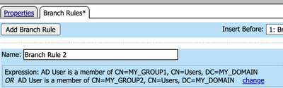

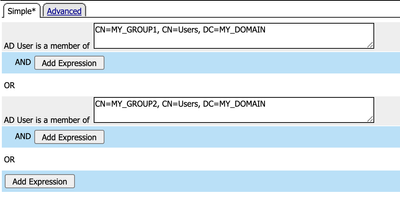

So the complex part is mostly just how to construct the TCL to put into the branch rules. VPE has a feature called "expression builder" that lets you construct many of these common ones easily. In the GUI this is called a "simple" expression. You can do something like this as a "this group or that group" kind of selection:
Clicking Finished results in a branch rule that looks like this:
You can then go and examine the actual TCL that the expression builder constructs by clicking "change", then "advanced":
Of course you'll need to modify the LDAP DN to match whatever your AD controller sends back from the query, either a full DN or a substring. You can see it uses "contains" so it can be a partial match too.
