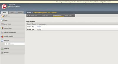

After the bigip upgrade, the device status is abnormal and the configuration cannot be loaded

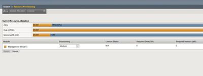

My device version is bigip- 14.1.2.3, the upgraded version is 15.1.5.1, ASM and AVR modules are used, and now after switching from version 14 to version 15, the status of the device changes to "UNKNOWN", and the configuration cannot be loaded , the module cannot be displayed and loaded normally, and it will return to normal after returning to version 14. Doing a "load sys config verify" reload also doesn't load properly.
