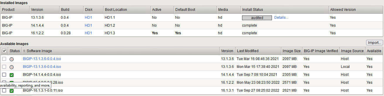

Hi,
I'm trying to install 16.1.3.1 over a Boot Location where 13.1.3.6 was some time ago (I do have 3 boot locations over all). Once the image gets tested it does not install as it should but instead the old software version goes into "Audited" status with not progress whatsoever. This lasts indefinetly (or at least it did not change after several hours today...).
I'm upgrading from 16.1.2.2 to 16.1.3.1
I rebooted the box, It went back to normal but once I tried to install new soft again it once more gets stuck in audited.
Also - it seems that the device makes a local copy of the image as I'm quite sure I deleted the local copy of 13.1.3.6 from the device before I reattempted the installation. (see screenshot).
No entries are appearing in the liveinstall.log and when I do show sys software it does show the audited status:
Sys::Software Status
Volume Product Version Build Active Status Allowed Version
HD1.1 BIG-IP 13.1.3.6 0.0.4 no audited yes
HD1.2 BIG-IP 14.1.4.4 0.0.4 no complete yes
HD1.3 BIG-IP 16.1.2.2 0.0.28 yes complete yes
This happens on a VCMP guest. The host is currently running 16.1.3.1
Another attempt at install is not possible unless I reboot the device.
Any ideas?

[user@device:Active:In Sync] shared # ll /shared | grep noupgrade
[user@device:Active:In Sync] shared # tmsh show sys software
HD1.2 BIG-IP 16.1.2.2 0.0.28 yes complete yes
HD1.3 BIG-IP 14.1.4.4 0.0.4 no complete yes
[user@device:Active:In Sync] shared # clsh rm /shared/noupgrade
=== slot local ===
rm: cannot remove '/shared/noupgrade': No such file or directory
