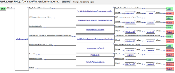

When access policy rejects send a 403 response for server-less Client
We have a scenario when user gets authenticated and gets rejected based on group check. We need to send a 403 instead of showing the access denied page. I tried several approaches but nothing worked. I tried out a per-request irule trigger but its not working.
Below is the per-request policy what we have

  • This is the irule which is in place.
    when ACCESS_PER_REQUEST_AGENT_EVENT {
      set id [ACCESS:Smiley Tongueerflow get perflow.irule_agent_id]
      set mylandinguri [ACCESS::session data get "session.server.landinguri"]
      if { $id eq "403" } {
        log local0. "Hit first iRule agent in PR policy"
        ACCESS::session remove
        HTTP::respond 302 "Location" "service-dev.wecenergygroup.com/rest/" "Connection" "Close"
    when HTTP_REQUEST {
      if {
        [HTTP::uri] eq "/rest/"}{
        log local0. "URI found"
        HTTP::respond "403"
    If any suggestions that would be appreciated.
  • For any other interested in the future, I solved it using a flag variable in ACCESS_PER_REQUEST_AGENT_EVENT event, and using HTTP::respond in HTTP_RESPONSE_RELEASE event.
