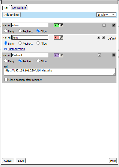

  •  Do you mean like this?
    Setup your APM policy so instead of deny you make a new end which is a redirect?
    So at the top of the policy click Edit Endings
    You then see this, click "Add Ending" and select the redirect radio button and set it where ever you want it to go.

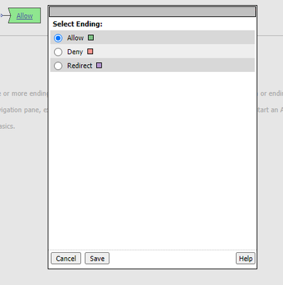

    The click on the Allow/Deny and change the Ending to the new redirection ending (or what ever you called it)

  • Thanks, it's been awhile since I'd done the training labs and forgot you had to add the additional endings.
