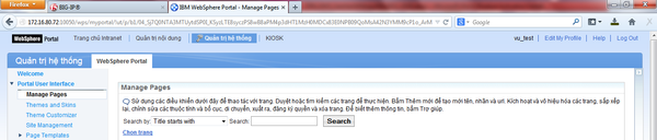

I had Virtual Server 172.16.80.72 with pool 3 APP Webshpere 172.16.85.71:10039,172.16.85.72:10050, 172.16.85.73:10050. VS's irule redirect from http://172.16.80.72 to http://172.16.80.72/wcs/portal. After configuration, client access it well but webmaster has few complaints. After login to admin website, admin interface broken icons. When click the tab for system administrator, error message display "Google chrome could not connect http://172.16.80.72:10050/wcs/myportal". I want to use VS replace the edge server 172.16.80.32. If click the tab for system administrator on 172.16.80.32, access link is http://172.16.80.32/wcs/myportal. How to resolve problem ? I need config on F5 or request webmaster config for http response from server app to F5 auto change the service port from 10050 to 80.

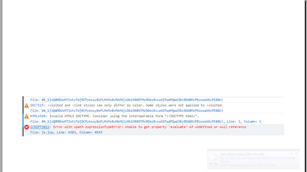

Dear Patrik
I see Script5022: Error with xpath expressionTypeError: Unable to get property 'evaluate' of underfined or null reference.
Thanks
Hi!
I guess the error above can be a result of failed http requests. Do you see any such things in the network part of the developer console?
Did you try altering the http profile?

I have new idea. I had created 2 new virtual server VS_01 172.16.80.72:10050 (member 172.16.85.72:10050 and 172.16.85.73:10050) and VS_02 172.16.80.72:10039 (member 172.16.85.72:10039). Then I can access to system administrator tab on administrator interface. But link display is http://10.64.80.72:10050/wps/myportal or http://10.64.80.72:10039/wps/myportal. My webmaster don't want to show it. He want to it display http://10.64.80.72/wps/myportal.
How to config rewrite for it ?
