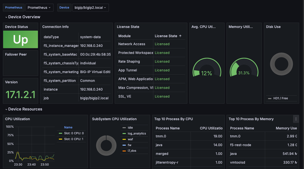

Here is an example of a dashboard folder in a non-AST Grafana instance after importing three dashboards from AST:
