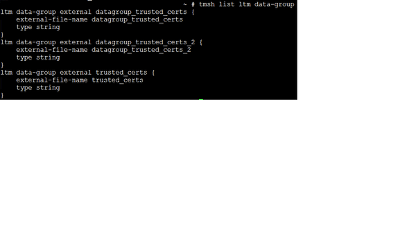

Can you provide the output of
tmsh list ltm data-group trusted_certs - ciscoarc
I can't seem to include any arguments after data-group

It's an external file, so you can't list the contents. Try:
cat /config/filestore/files_d/Common_d/data_group_d/\:Common\:trusted_certs* - ciscoarc
