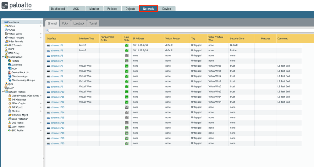

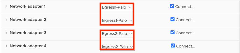

If you haven’t already configured the Palo Alto Virtual Machines there are a few things to be aware of.  For the ESX Network configuration you will need 4 interfaces at a minimum. The configuration should look something like this:
The corresponding Palo Alto network settings should look something like the image below.

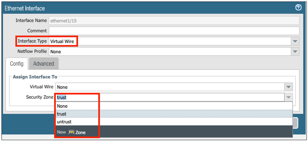

Click the name (ethernet1/X) of the interface you wish to configure.
Set the Interface Type to Virtual Wire and the Security Zone to trust.  Click OK.
Do the same for the next interface.

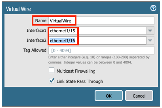

Click the name of one of the interfaces configured previously.  Click Virtual Wire > New Virtual Wire.
Give it a name.  Select the 2 interfaces configured previously.  Click OK and OK.
You will need to Commit the changes for them to take effect.

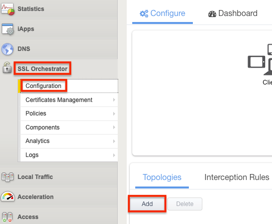

From the BIG-IP Configuration Utility select SSL Orchestrator > Configuration.  Click Add under Topologies.

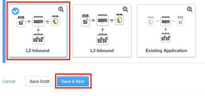

Select L2 Inbound as the Topology type then click Save & Next.

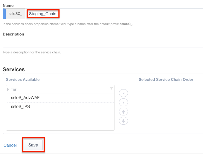

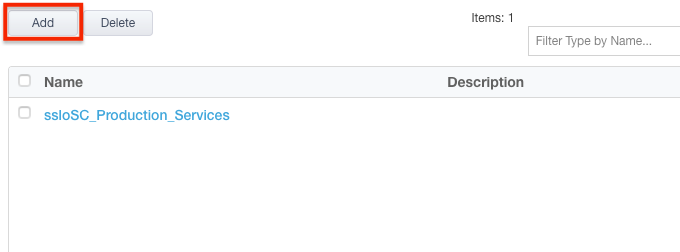

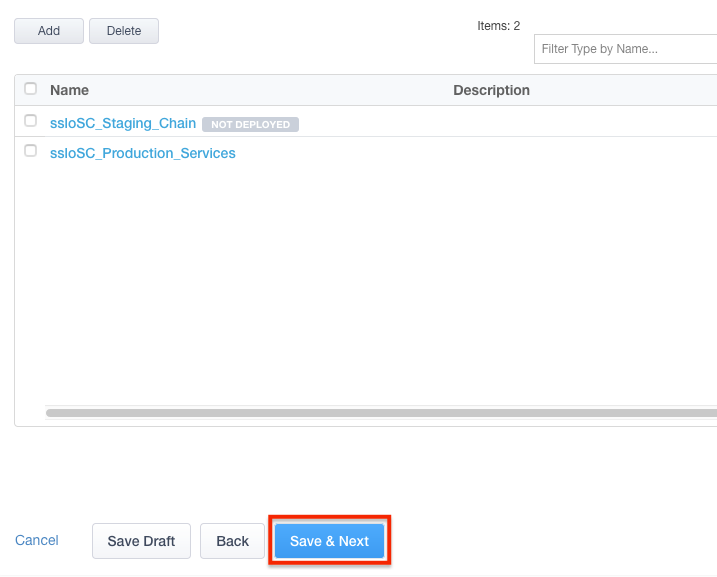

Click the Add button under Services Chain List.  A new Service Chain is needed so we can remove PaloAlto1 from the Production Service and add it here.
Give the Service Chain a name, Staging_Chain in this example.  Click Save at the bottom.
Note: The Service will be added to this Service Chain later.
Click Save & Next.

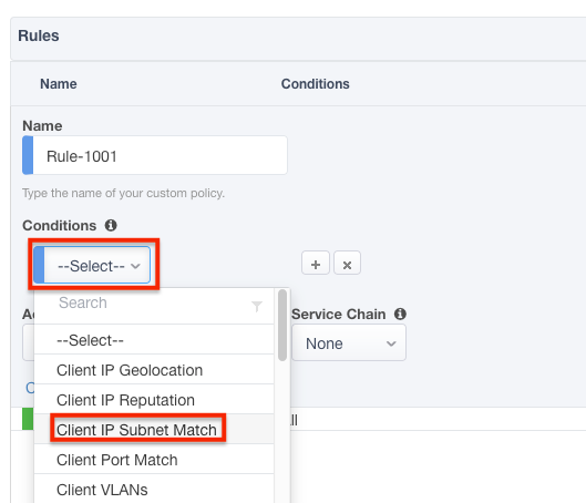

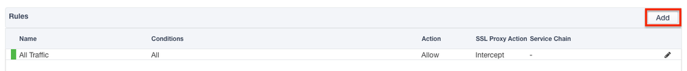

Click the Add button on the right to add a new rule.
For Conditions select Client IP Subnet Match.
Enter the Client IP and mask, 10.1.11.52/32 in this example.  Click New to add the IP/Subnet.

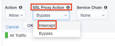

Set the SSL Proxy Action to Intercept.
Set the Service Chain to the one created previously.
Click OK.
Note: This rule is written so that a single client computer (10.1.11.52) will match and can be used for testing.  In the All Traffic default rule set the SSL Proxy Action to Bypass.

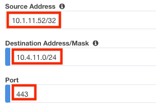

For the Interception Rule set the Source Address to 10.1.11.52/32.  Set the Destination Address/Mask to 10.4.11.0/24.  Set the port to 443.

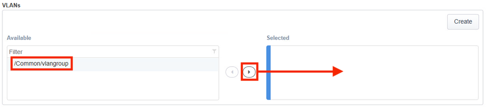

Select the VLAN for your Ingress Network and move it to Selected.

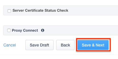

For Log Settings, scroll to the bottom and select Save & Next.

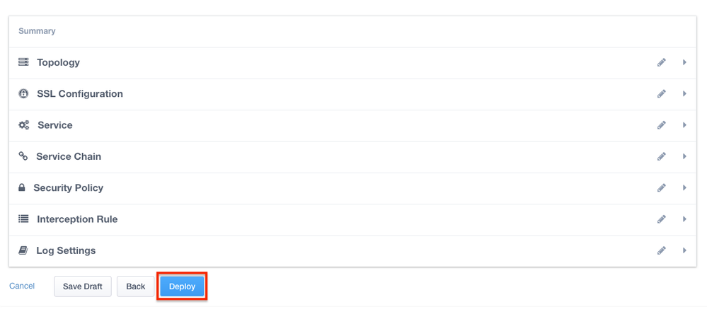

Click Deploy.

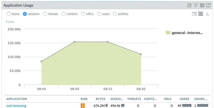

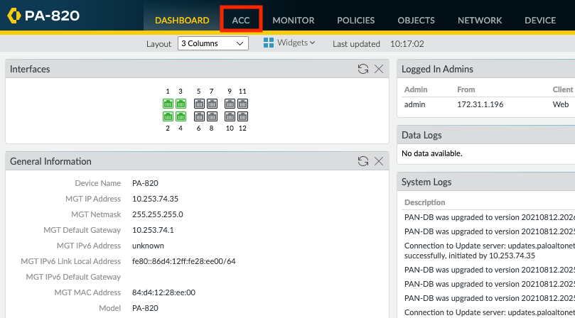

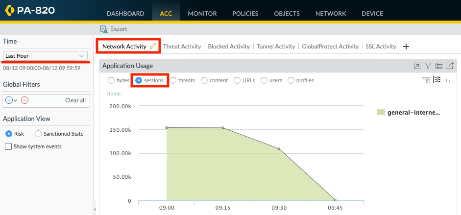

Check the statistics on the Palo Alto NGFW we will be performing maintenance on.  It’s “Palo_Alto1” in this example.
From the Palo Alto GUI select ACC (Application Command Center).
Select Network Activity then Sessions.  A time filter can be set on the left, in this case it’s set to the Last Hour.
Palo_Alto1 appears to be completely healthy.

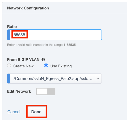

Change the Weight Ratio

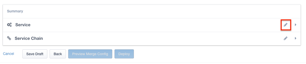

Back to the SSL Orchestrator Configuration Utility.  Click SSL Orchestrator > Configuration > Services > then the Service name, ssloS_PALOALTO in this example.
Click the pencil icon to edit the Service.

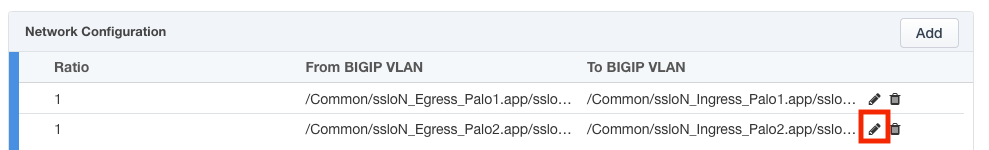

Click the pencil icon to edit the Network Configuration for PaloAlto2
Set the ratio to 65535 and click Done.
Note: Alternately you could disable the Pool Member from LTM > Pools.
Click Save & Next at the bottom.

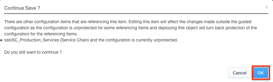

Click OK if presented with the following warning.
Click Deploy.
Click OK when presented with the Success message.

Check the ACC statistics on “Palo_Alto1”.  It should look like the image below, with the number of sessions tapering off until there is zero.

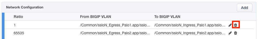

Remove a single Palo Alto VM from the Service
Under Network Configuration, delete Palo1.
Click Deploy.
