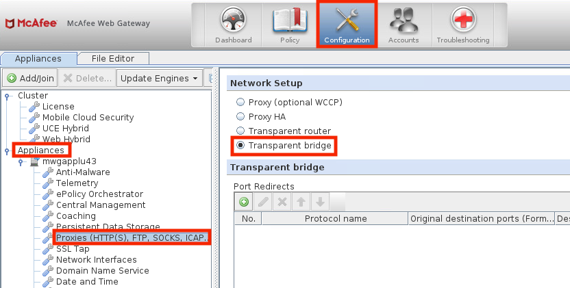

From the MWG UI navigate to Configuration > Appliances > Proxies.  Under Network Setup select Transparent bridge.
Click Save Changes on the top right

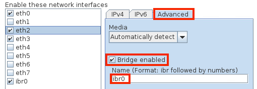

Navigate to Network interfaces. In this example eth2 and eth3 will be used to create the Transparent bridge. Both interfaces need to be enabled and the IP settings must be disabled for IPv4 and IPv6.
On the Advanced tab enable the bridge and give it a name, ibr0 in this example. Do this for both interfaces.
Save changes

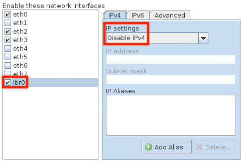

Check ibr0 and set it to enabled.  Disable IPv4 and IPv6
Click Save Changes

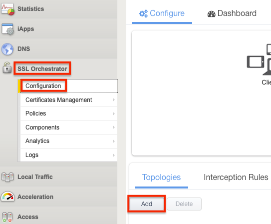

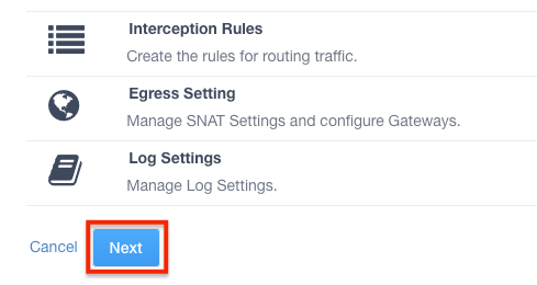

From the BIG-IP Configuration Utility select SSL Orchestrator > Configuration.  Click Add under Topologies.

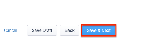

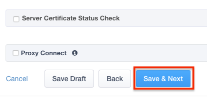

Scroll to the bottom of the next screen and click Next.

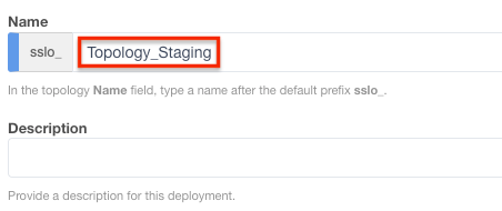

Give it a name, Topology_Staging in this example.

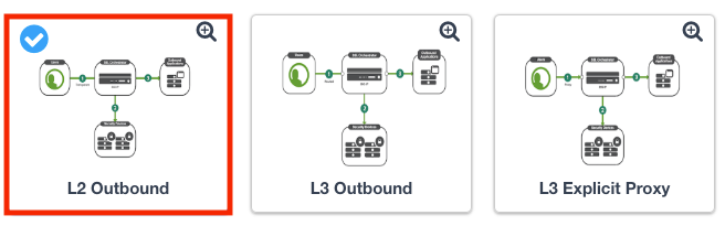

Select L2 Outbound as the Topology type then click Save & Next.

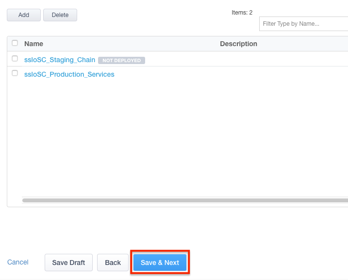

Click the Add button under Services Chain List.  A new Service Chain is needed so we can remove McAfee Web Gateway from the Production Service and add it here.
Give the Service Chain a name, Staging_Chain in this example.  Click Save at the bottom.
Note: The Service will be added to this Service Chain later.
Click Save & Next

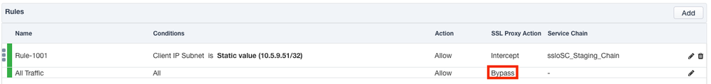

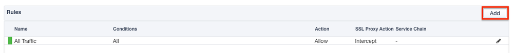

Click the Add button on the right to add a new rule.

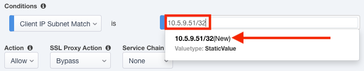

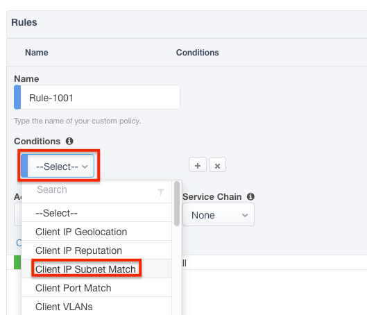

For Conditions select Client IP Subnet Match.
Enter the Client IP and mask, 10.5.9.51/32 in this example.  Click New to add the IP/Subnet.

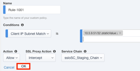

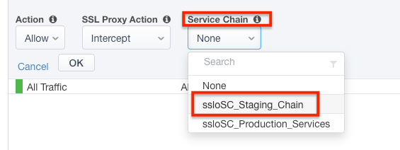

Set the SSL Proxy Action to Intercept.
Set the Service Chain to the one created previously.
Click OK.
Note: This rule is written so that a single client computer (10.5.9.51) will match and can be used for testing.  In the All Traffic default rule set the SSL Proxy Action to Bypass.
Select Save & Next at the bottom.

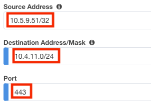

For the Interception Rule set the Source Address to 10.5.9.51/32.  Set the Destination Address/Mask to 10.4.11.0/24.  Set the port to 443.

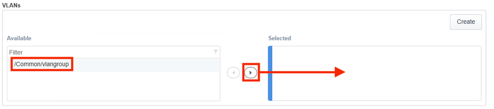

Select the VLAN for your Ingress Network and move it to Selected.

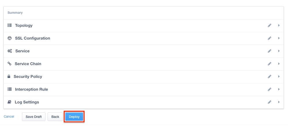

Click Deploy.

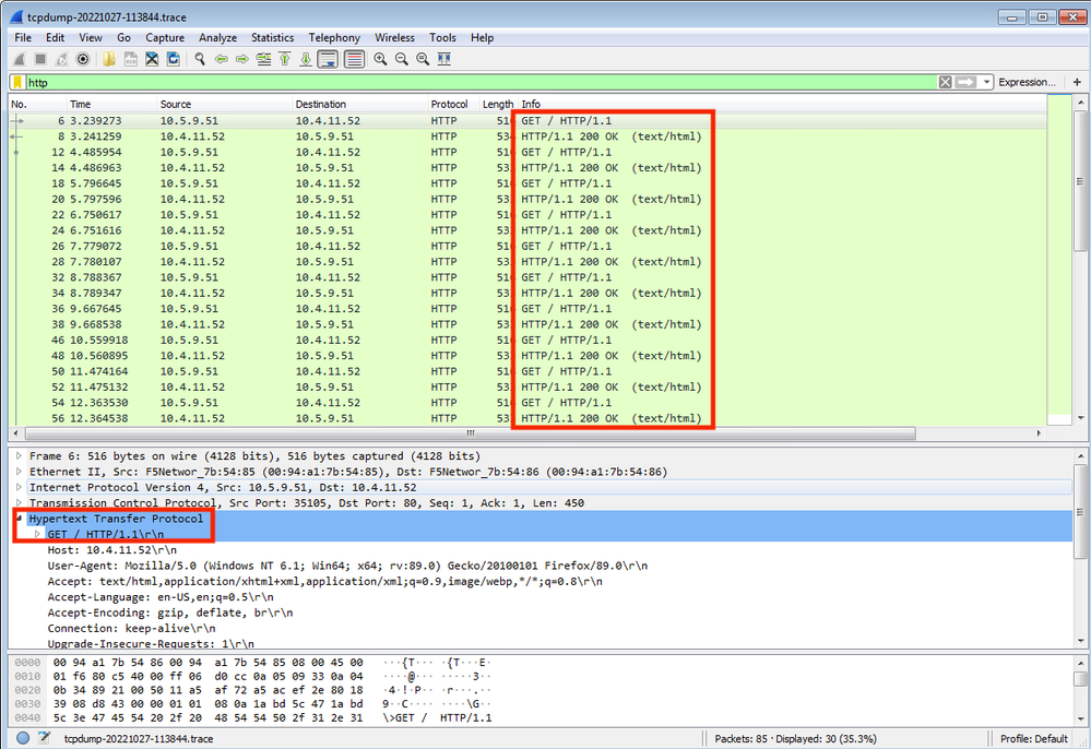

Check the statistics on the McAfee Web Gateway device we will be performing maintenance on.  It’s “MWG1” in this example. One way to do this is with a packet trace. From the McAfee Web Gateway UI go to Troubleshooting > Packet tracing. I set the Command line parameters to “-I ibr0” which will capture all packets on the bridge interface.
Note: This McAfee Web Gateway device is actively processing connections. Note the connections are in clear text, HTTP on port 80. SSL Orchestrator decrypted the SSL/TLS and sent it to the McAfee device for inspection.

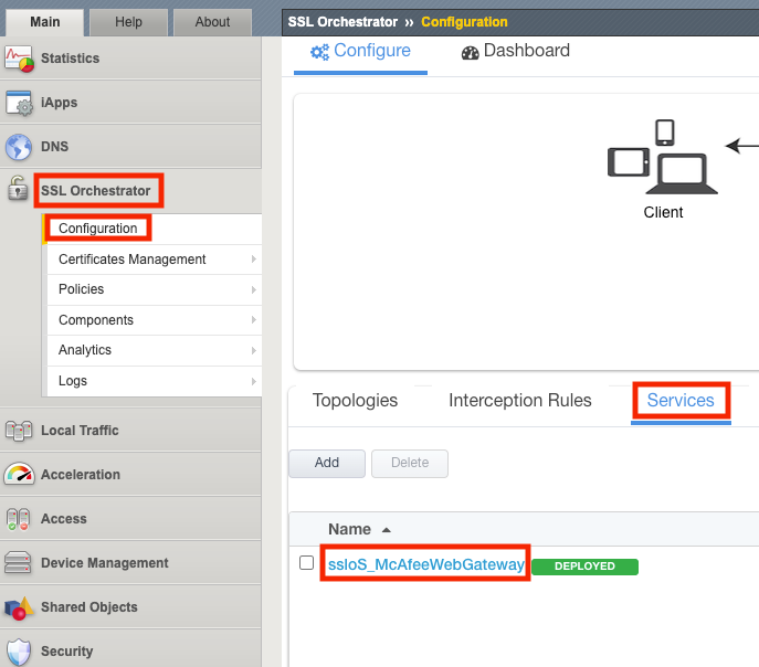

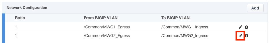

Back to the SSL Orchestrator Configuration Utility.  Click SSL Orchestrator > Configuration > Services > then the Service name, ssloS_McAfeeWebGateway in this example.

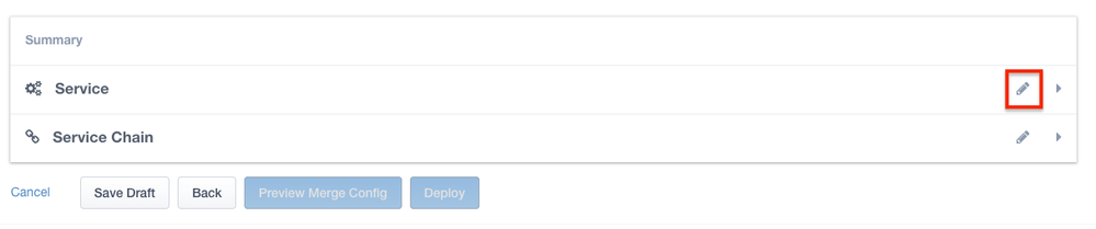

Click the pencil icon to edit the Service.

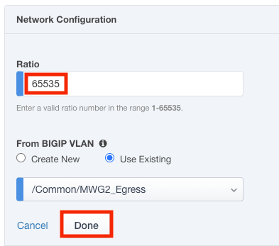

Click the pencil icon to edit the Network Configuration for MWG2
Set the ratio to 65535 and click Done.
Click Save & Next at the bottom.

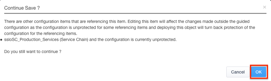

Click OK if presented with the following warning.

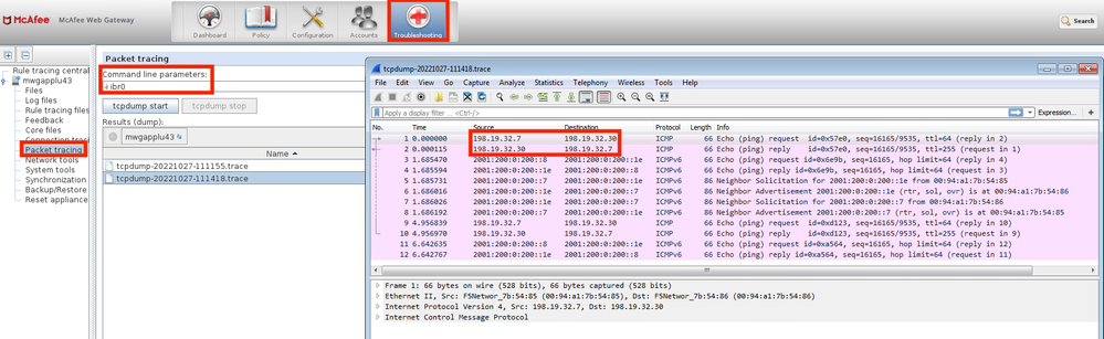

Check the statistics on the McAfee Web Gateway device again. It’s “MWG1” in this example.  From the McAfee Web Gateway UI go to Troubleshooting > Packet tracing.  I set the Command line parameters to “-I ibr0” which will capture all packets on the bridge interface.
It should look like the following:
Note: The connections above represent the health checks from SSL Orchestrator to the inline Service. Therefore, this McAfee Web Gateway is not actively processing connections.

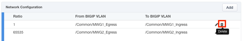

Under Network Configuration, delete MWG1.
