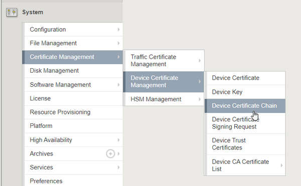

  • If you're running a newer device you can add the chain via the UI:
    If running a v12 you can follow this guide:
    https://support.f5.com/csp/article/K13302

      Installing the cert, chain and root separate in F5 it does not work.
