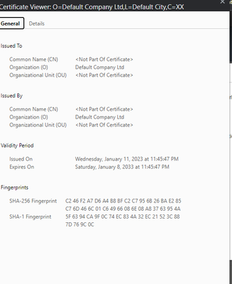

We recently updated a device certificate on an F5 device but we encounted lost access on the GUI after the device cert application. We stumble upon this article https://support.f5.com/csp/article/K52731589 and did the steps on there.
After leaving everything in default and restarting HTTPD, the access on the GUI worked again. Now the problem is this,
We managed to make the certificate import work but only the information on the System>Certificate Management>Device certificate is updating. When we check the browser, we see this below
My question is how can we update the info on the browser as well? Or how can we revert the changes to it?

  • what the browser shows is the info you provided when you typed the command F5 suggested:
    openssl req -new -x509 -key ../ssl.key/server.key -days <# of days> -out server.crt
    what specifically you'd like to update in the browser?
    If you've already replaced the cert with the Linux command in the article you've already replaced the old cert. Unless you backed it up, I think it's gone.

      I only did the recommendation on the article to regain access to the GUI. I have a backup of the device cert but when I import it, the browser still shows the same as the screenshot above.
      -I would like to see matching details on the F5 Device cert page and the browser's. As of now they are not the same.
