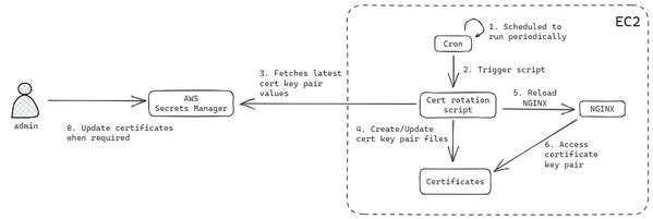

Polling

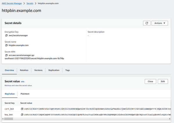

With the TLS certificates stored as secrets on AWS Secrets Manager, they can be accessed by calling the AWS Secrets Manager API. The values containing the TLS certificates (stored in base64 encoding under the cert_b64 and key_b64 keys in the sample screenshot below) can then be stored locally on the NGINX instance.
The script below shows an implementation example with use of the AWS CLI:
#! /usr/bin/env bash set -e # Fetch a list of secrets of interest. Using filter to find secrets with certain tags as AWS Secrets Manager does not support multi-tenancy secrets=$(aws secretsmanager list-secrets --filters "Key=tag-key,Values=nginx-cert-rotation" | jq -r '[.SecretList[].Name]|join(" ")') echo "Found $secrets" # Loop through each secret name, fetch the the key pair values and store them locally in /etc/nginx/certs for secret_id in $secrets; do echo "Processing $secret_id"; # certificate public key is stored in the cert_b64 key, base64 encoded aws secretsmanager get-secret-value --secret-id "$secret_id" | jq -r .SecretString | jq -r .cert_b64 | base64 -d > "/etc/nginx/certs/$secret_id.crt"; # certificate public key is stored in the key_b64 key, base64 encoded aws secretsmanager get-secret-value --secret-id "$secret_id" | jq -r .SecretString | jq -r .key_b64 | base64 -d > "/etc/nginx/certs/$secret_id.key"; echo "Success"; done # reload nginx if is running systemctl is-active --quiet nginx.service && nginx -s reload || true
When executed at regular intervals, using cron or something similar, admins can update the TLS certificates on AWS Secrets Manager and expect the changes to be reflected on the NGINX instances within a reasonable time. This is similar to how NGINXaaS for Azure enables certificate management via Azure Key Vault, where it automatically rotates certificates every 4 hours.
