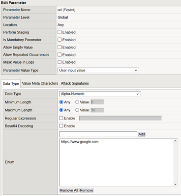

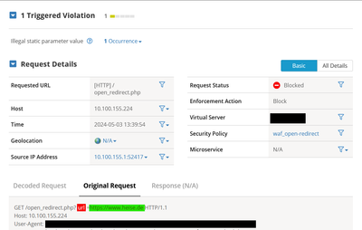

  • Hi OM
    if this it the request: "https://website.com/redirect.jsp?url=https://google.com"
    Then url is a parameter and https://google.com is a parameter value. In ASM you can control which parameter values are allowed. Issue solved.
    Sample config:
    And the result:
    KR
    Daniel

    • Hi OM
      Sample config:
      And the result:
      KR
      Daniel
      • OM's avatar
        OM
        Thanks Daniel, that's what I did as a workaround.
        The problem with that approach is, we don't have the full picture of what the website has as redirects and I try hard to avoid false positives....
        I was hoping to have a built-in feature similar to open redirect in Location Header.
        Anyways, I will keep an eye on the other redirects and eventualy refresh the list of parameters if another false positive pops up.
