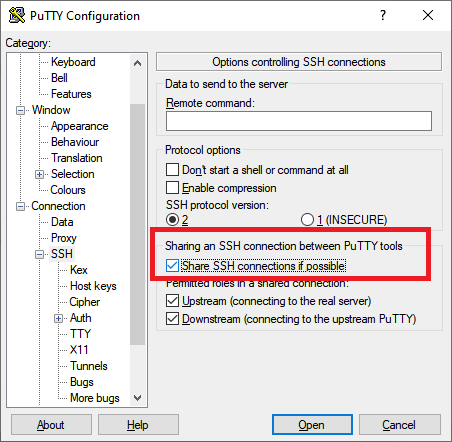

  • SSH indeed allows multiple client instances to use 1 ssh session.
    in putty, this setting allows it.
    i dont need to login on my second and subsequent putty windows when connecting to same ssh server
