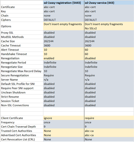

We have a registration VS and a service VS. Both VS's have their own client ssl profile (no server profile). Below are the differences in the ssl profiles:
I am tasked with getting rid of port 5443 and making it so that customers can both register and hit the service on port 443/https. The majority of the traffic comes in on 443 with the occasional new customer registering first on 5443. The VS's point to different pools. We are running BIG-IP 11.3.0 Build 2806.0 Final.
With that being said, I'd like to make the 2-way ssl profile the default and turn off client auth if uri equals "/register". Here is what I have so far...
