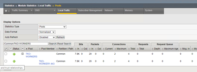

Hello,
I am trying to setup bigip on another site. I already have a working set of LB in one site. I am tryng to deploy this setup to another site. While I don't have problem of setup it mainly, I faced a problem that I don't know how to solve.
Currently, the VS have requests but the POOL request is 0 (the pool have been assigned as the default pool to the VS) . I don't understand this. I tried to SSH in the bigip and can telnet to the pool member 443 successfully with respond. The problem is just it does not make any request (request is 0.)
Any idea please? Thanks for your help.
  • Hi,
    Did you apply address translation - Automap to the VS? could you execute this command in both devices to validate if the configuration is the same:
    tmsh list ltm virtual <name of the virtual>

      Hello,
      Thanks for the hint, yes, i forgot to setup Automap. It is all fine now.
