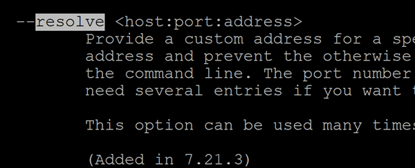

Using curl you can add the “—resolve” flag to insert the SNI name.
The format would be:
curl –resolve sni_value.example.com:port:ip https://sni_value.example.com:port
