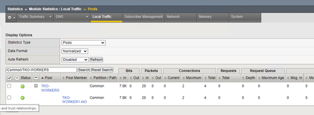

Troubleshooting between VS , POOL and the members
Hello, I am trying to setup bigip on another site. I already have a working set of LB in one site. I am tryng to deploy this setup to another site. While I don't have problem of setup it mainly, I f...

    Hi,
    Did you apply address translation - Automap to the VS? could you execute this command in both devices to validate if the configuration is the same:
    tmsh list ltm virtual <name of the virtual>
