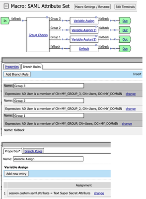

I would probably suggest using the Empty Agent's branch matching capabilities inside of a macro to set the attribute based on group matching like that. It is pretty capable for that feature.
Something like this:

Your solution would work.
However, it's not a route I want to take, our VPE is already cluttered enough, with ten or so fairly complex macros. I'm trying to keep it as general as I possibly can, and put the complexity in either iRules or - as I really wanted to do this time - in the actual SAML attribute value.
If I can't have it my way, I'm still undecided whether I'll go the iRule route or the VPE route.
I'll keep you guys posted. 🙂

Did you end up figuring out a solution? I am also in the same boat. Empty branch rules dont work for me because I might have someone that has belongs to two of the groups and needs to access both. An irule would just clutter everyone with a ton of variables. Being able to assign a default in the saml variable value field would be awesome.
