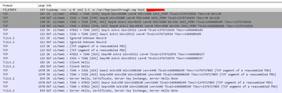

Yes, this is 100% correct. Traffic starts out as just regular TCP traffic and then changes to TLS anc continues as both TLS and TCP traffic. Here is wireshark output from a good connection (SSL passthrough).
You can see that the communication that's going on is both TCP and TLS traffic on the same port. So are you saying the F5 is incapable of SSL bridging in this situation?
