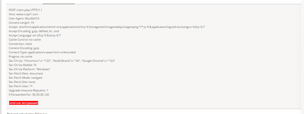

Case 1 - Command Injection
The following payload is detected:
POST /clam.php Content-Type: application/x-www-form-urlencoded cmd=cat /etc/passwd
AWAF triggers:
Unix "cmd" parameter execution attempt

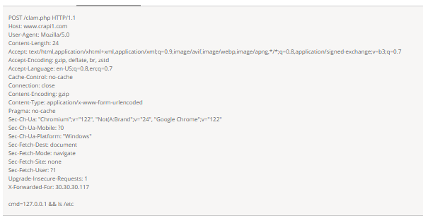

However, the following payload is not detected:
POST /clam.php Content-Type: application/x-www-form-urlencoded cmd=127.0.0.1 && ls /etc
The request body is visible in the event logs, so parsing appears to be working correctly.
Has anyone observed similar behavior with command execution signatures?

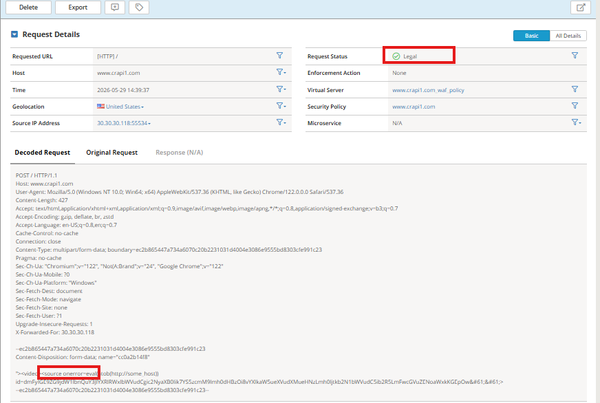

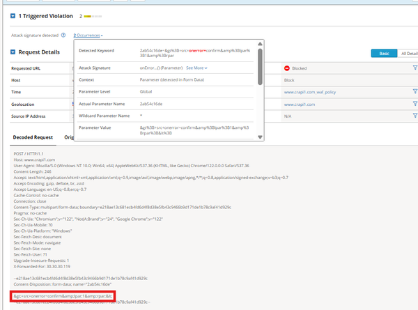

However, some multipart XSS payloads are not detected, for example:
Content-Disposition: form-data; name="random" <x/Onpointerrawupdate=confirm()>xxxxx
while other XSS payloads such as onerror-based payloads are detected and blocked.

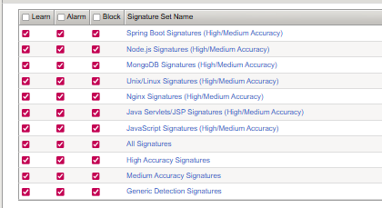

Have you enabled specific attack-type signatures and enforced them within the security policy? For example, signatures related to command execution or Cross-Site Scripting (XSS).
Have a good read about Multipart/form-data below.
About POST /clam.php Content-Type: application/x-www-form-urlencoded cmd=127.0.0.1 && ls /etc maybe see if there is no low level signature about this as if you are using medium/high level only this could be it. Also if you selected specific server technologies maybe then if this is a signature for Linux but you selected Windows in server technologies this could explain the Linux signatures are not applied.
I think I saw similar stuff 2 years and if needed raise F5 case but maybe this is considered not affecting currently systems (who knows ) and you may need to write a custom signature for it if F5 says that for them this is not security risk and this is not covered by low level signatures.
