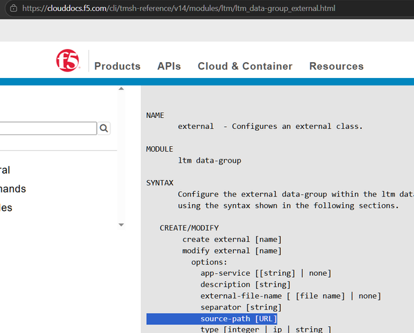

you can try to use shell comand/script that executes tmsh to update external datagroup.
put the script/command in the crontab scheduler of bigip linux host
https://clouddocs.f5.com/cli/tmsh-reference/v14/modules/ltm/ltm_data-group_external.html
