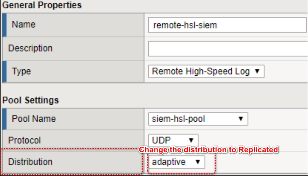

  •  Hi Awan,
    Use Distribution setting as == Replicated
    Default is Adaptive
    There are three options for this Distribution setting:
    • Adaptive == Default Setting

    • Replicated
      This method replicates each log to all pool members of the HSL pool. This method is typically used when you want to have the same set of logs on another backup remote log server.

  • Hi Awan,
    replicated option is for pool only not for publisher. In tmsh here is the syntax
    create /sys log-config destination remote-high-speed-log <log destination name> distribution <adaptive|balanced|replicated> pool-name <HSL pool name> protocol <tcp|udp>
