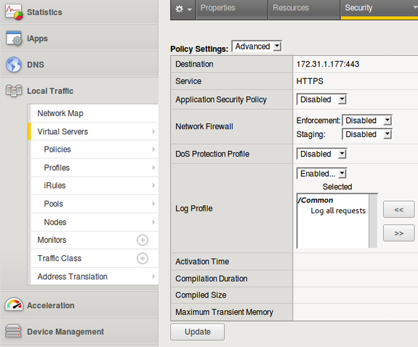

  • Can you provide details on what you mean by disabling the policy of the ASM?

  • We mean to the fact that politics has not activate in the VS, as seen in the image. We have not created any irules.
