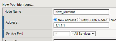

      When you create a Pool Member, you can set it ports to "* All Services".
      In this case, the Pool-Member will inherit the DST port of the VS when forwarding to it. The VS could also be set to * All Services, which would allow you to setup a VS-many-to-many-Pool port mapping.
      When working with such * All Services rule sets, then you have to keep in mind that the Health-Monitor wont know which port to monitor, so you have to specify a port at the Monitor-Level.
      Only if you have specified a Port at your Pool-Member, the monitor will become able to inherit the Port of the Pool-Member via the default "* All services" option.

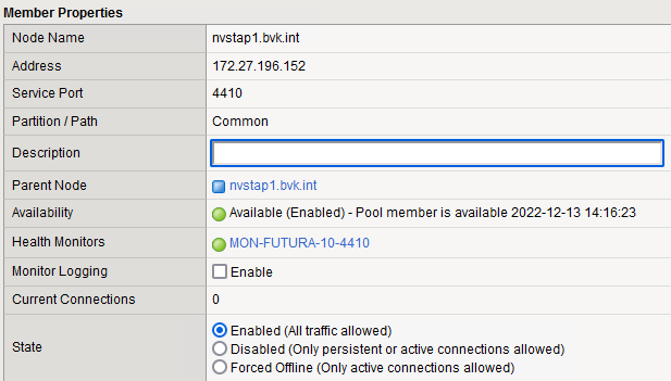

  • kgaiglIf your pool member has a port defined then the health monitor will absolutely inherit the pool when it performs the health check. To me it sounds like you did not set the service port to a single port when creating the pool members. If you could provide a screenshot of the pool configuration we should be able to direct you further to resolve your issue. If you need to provide a redacted configuration that will work as long as it shows the port associated to the pool member and the health monitor configuration that you are using.

    ok, this is the Pool:

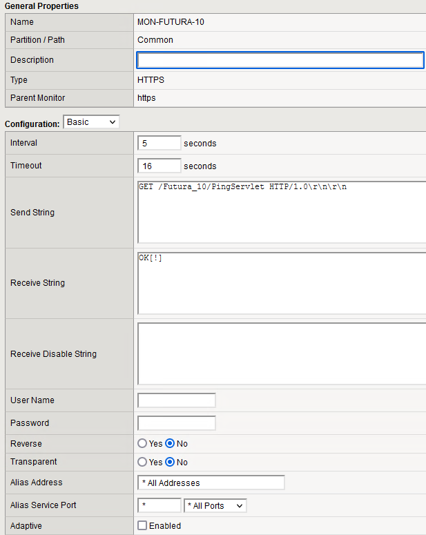

    with this Monitor, Member is down:

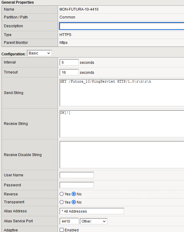

    with this Monitor the Member is up:

      when I first configured the Pool with the Monitor (all Ports), the Member didn't come up and I configured the Monitor with Port defiened.
      Now I tested again the original Monitor, Member gets green ğŸ¤”
