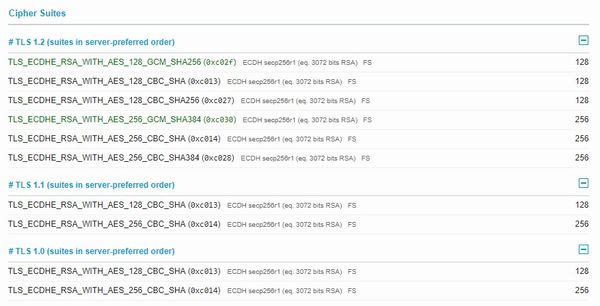

How to disable weak cipher from Client SSL Profile
Hi, We have disabled few ciphers and we have rating "A" in qualys ssl checker portal. We have a requirement to disable weak ciphers as well.
Could some one advice how to disable weak ciphers. Please find the attachment for reference.
Thanks

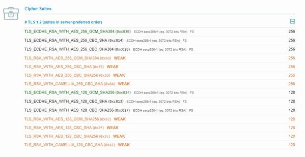

      Hi Kaustubh,
      I have made the changes suggested by you and i got the below output from ssl checker.
      Thanks for your suggestions
      Regards Sriram

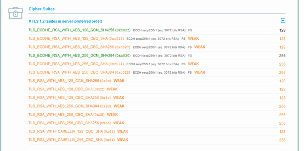

      Hi Kaustubh,
      After the change the TLS 1.0,1.1 was enabled.
      Our requirement is to have TLS 1.2 alone and rest all protocols should be disable.
      Please suggest a cipher for this requirement.

      Hi Kaustubh,
      Regards Sriram

      Hi Kaustubh,
  • By using DEFAULT:@STRENGTH command you can preferred the ciphers to use only Strength.

      Hi Lokesh,
      Thanks for your suggestions.
      After making the changes, i got the below output.
