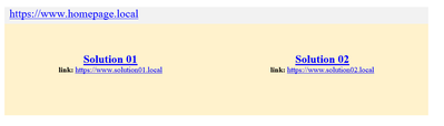

Example of desired home page:
My question, do we need to separated reverse proxy to host the main page or we can implement this through F5 Big-IP

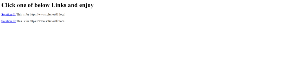

  • Hi Fernando_M ,
    I have written this  irule for you , it as follow :
    when HTTP_REQUEST {
       HTTP::respond 200 content {
          <html>
             <head>
             </head>
             <title>https://www.homepage.local</title>
             <body>
               <h1>Click one of below Links and enjoy</h1>
             </body>
             <body>
             <p>
               <a href="https://www.solution01.local">Solution 01</a>
               This is for https://www.solution01.local
             </p>
             </body>
             <head>
             </head>
             <body>
             <p>
               <a href="https://www.solution02.local">Solution 02</a>
                This is for https://www.solution02.local
             </p>
             </body>
          </html>
    Create the below >>

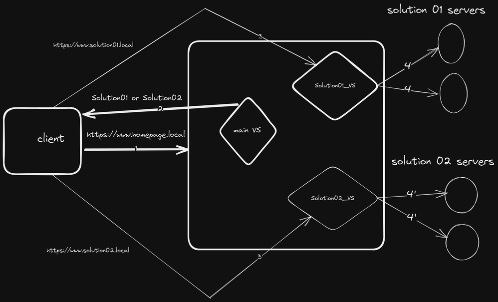

    1) Two separate Virtual servers for Solution 1 and Solution 2 and attach the required pools as you mentioned in your inquiry.
    2) the irule will embed these urls in the web page and will be depend on your choice ( Solution 01 or Solution 02 )
    3) Create The main Virtual server for this url   https://www.homepage.local and map it to main virtual server IP.
    you will need only to add assign http profile / Client ssl if there is ssl and attach the above irule to it without pools or anything else.
    you should see the below web page after when enter https://www.homepage.local
    According to my code : Solution 01 >>> includes embeded https://www.solution01.local & Solution 02 >>> includes embeded https://www.solution02.local
    you can Customize according your environment.
    Finally this is should be your traffic Flow :
    I tested each step and it worked with me.
    Some hints :
    >> Don't forget to make sure that https://www.solution01.local  Resolves to Solution01_VS IP &  https://www.solution02.local  Resolves to Solution02_VS IP.
    >> you can Customize your ( Solution01_VS & Solution02_VS ) to single virtual server , but you will need to create another iRule to select proper pool depending on the " Hostname " that comes in the request.
    Please Test it and let me know how it works with you ๐Ÿ™‚
