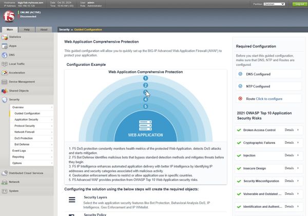

I’m trying to set up the WAF functionality using the UI on my F5 device (version BIG-IP 17.1.1.3 Build 0.0.5 Point Release 3) in a clustered environment. I’m going through the steps as follows:
Security -> Guided Configuration -> Web Application Protection -> Web Application Comprehensive Protection
When I attempt to use this guided configuration, a list of prerequisites appears. The primary issue seems to be that there are no routes configured, even though my DNS and NTP are set up. I don’t fully understand why route configuration is necessary for this WAF setup or what it should entail.
Additionally, if I try to bypass this warning and proceed with the deployment, I receive the following error message:
“Error: <IP> not discovered in any device-group.”
The F5 documentation doesn’t seem to cover this issue and I’m unsure how to resolve it.
