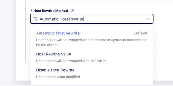

By default, XC with or without a route rewrites the Host value of the client’s http request to the origin server’s FQDN name in the origin pool (only if the origin server is FQDN, not IP address).

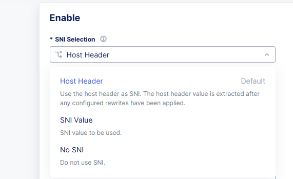

Under the XC origin pool, you can control the SNI selection for the origin pool. Sometimes having not the correct SNI could generate 400 errors for nginx origin web servers, for example.

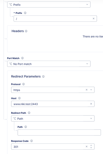

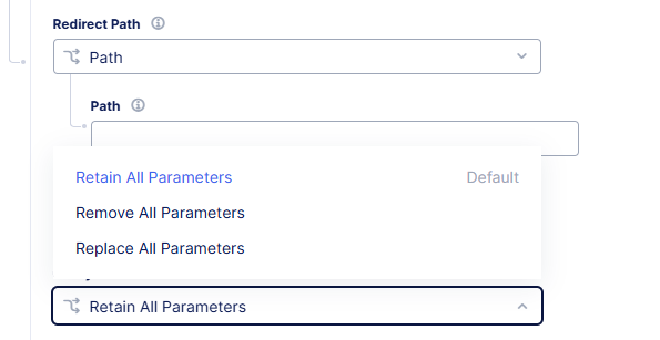

Under the XC HTTP LB route, you can configure host redirection even for non standard port. If you don't configure an explicit path option, then XC will auto-redirect and keep the original URL. I found this not something well-explained.

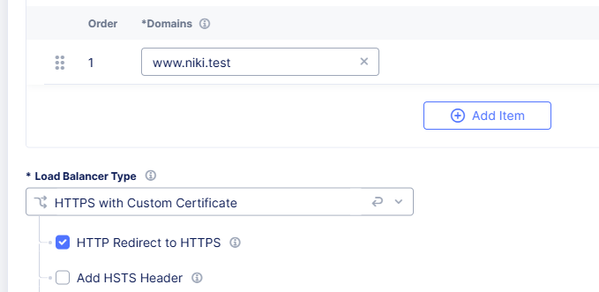

For basic HTTP to HTTPS redirection you can easily enable it under and HTTPS LB and the only issue is it assumes that HTTP is on port 80, so for custom redirection from HTTP on port other than 80 you need to use the below methods.
For any F5 experts out there this is similar to the default http to https redirection in F5 BIG-IP ADC or F5 NEXT ADC with system iRule _sys_https_redirect.

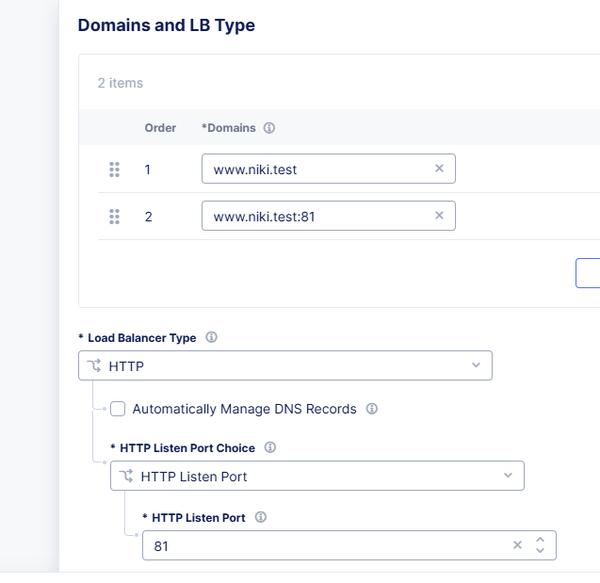

You can even configure the HTTP LB to listen on ports other than the default ones (80 for HTTP or 443 for HTTPS) and to redirect to also not custom ports. In some cases you will need to add the FQDN domain with the non-custom port. Some web browsers send traffic to not custom ports with the port in the host name and this could cause XC not to match the traffic.
To test this with "curl" that can even be directed with the "resolve" option to HTTP LB that the public DNS still does not direct to it.
This is similar to F5 BIG-IP/NEXT iRule TCL scripting where " [HTTP::uri] " or " [HTTP::path] " are used depending if you want the redirect to keep the query parameters or not. If you get a warning that the path option needs to be set ignore it as this seems a visual XC bug that should be solved at some point.

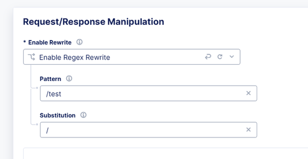

XC HTTP LB internal URL Rewrite
Under the XC HTTP Route advanced options, you can find the Request URL rewrite can match on prefix or even a regex to be used. This in some cases helps for apps that don't handle very well 3xx redirects (mobile apps are one such case) as for example "/test" URL is auto-changed to "/" otherwise 404 code would be seen if the page does not exist!
The rewrite option seems particularly useful for Customer Edge (CE) deployments that are inside the customer networks RE > CE traffic where the HTTP LB is on the RE and the origin servers in the origin pool are on the CE and the SSL/IPSEC tunnel between RE and CE is used to stich things.
