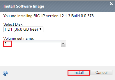

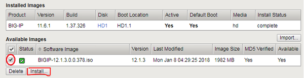

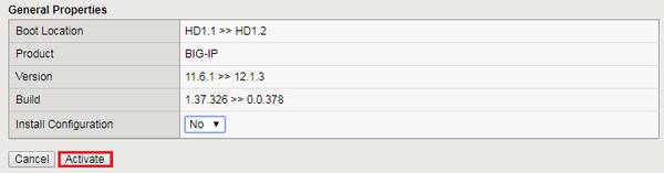

    With images...
    >> Install the new image
    >> Select a new volume name
    >> Activate the new volume HD1.2
    KR,
    Dario.

  • Actually, you cannot install your new release 13.1.4 on HD1.1, you need to create a new one..
    1) Upload the new image
    2) Install the new image, you need to define a new volume set (i.e., 2 -> HD1.2)
    3) Access volume H1.2 and active it (wait until reboot)
    KR,
    Dario.

      • cathy_123's avatar
        cathy_123
        wow thank you so much Dario! This is so informative. So when I click the install it will ask me to create a new volume set.
        Thanks!
